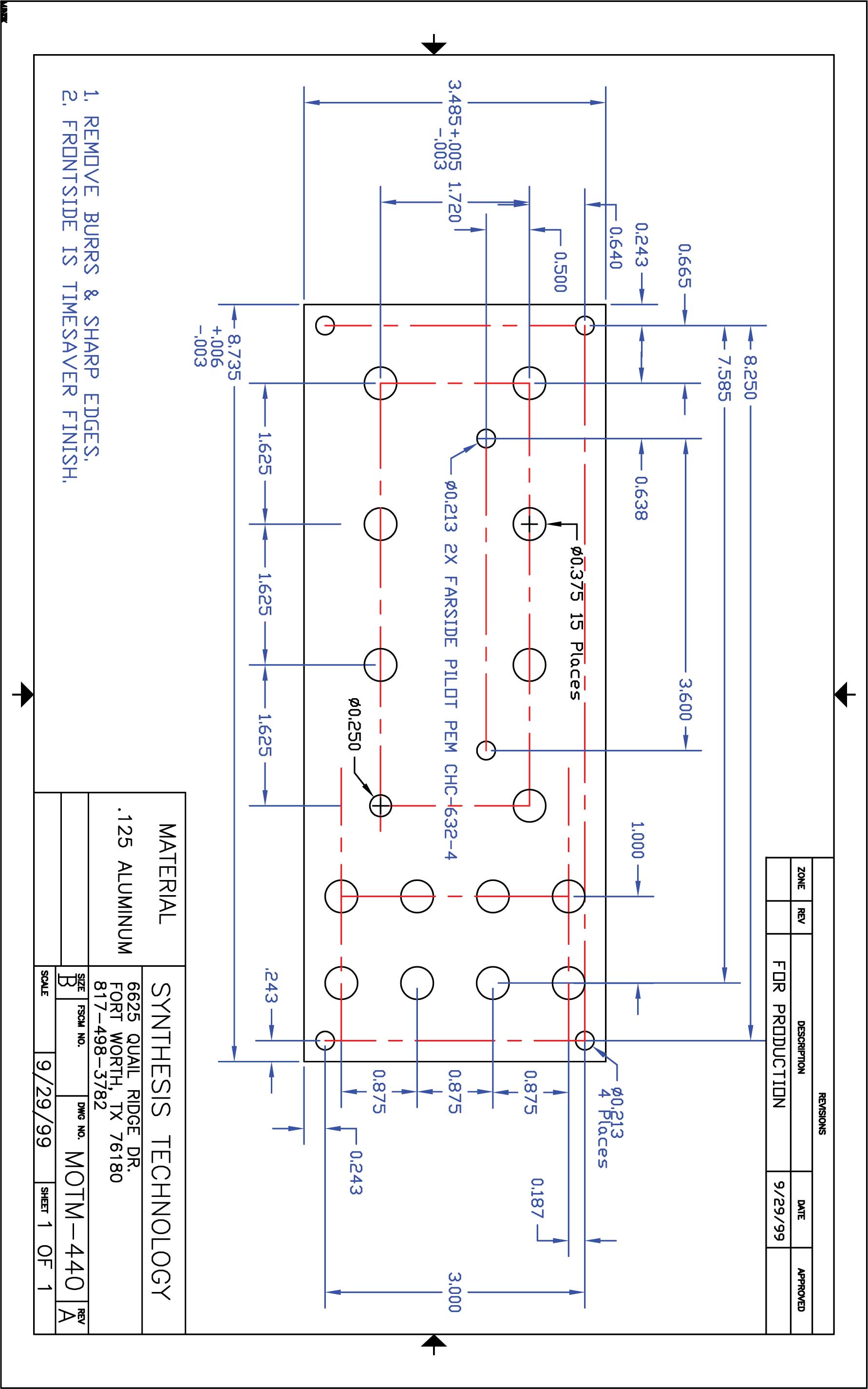

I have decided to post about my new project I'm working now. Maybe it will help me to get some advises and to avoid some mistakes.
I have written somewhere on the forum I repaired 1988 soviet 24 band vocoder. Now I made one channel based on its schematic but with changes. It works, but very hard to understand how it sounds because I have only one channel now. My channel sounds different than soviet analog, I think better but will can say exactly when will make all filterbank.
I replaced crappy old soviet single opmaps with TL074, and replaced transistor pairs VCA with THAT2180 VCA. Anyway DIP trans pairs cost equal to 2180 IC. The channel has turned out much more compact.
I already drew in Eagle filterbank board. 6 channels fit on the eurocard (160x100). So will be 5 boards - 4 for filterbank and one for in-out circuits and controls.
I made CV in and out pads on board for every channel, so if someone wants can make patch matrix.
In-outs circuits I plan completely remake. I think about THAT based mic amp, then (maybe) one knob limiter (THAT), then simply output summing amp (OPA2604) and 4-band EQ.
I drew simply sketch. Green are pots. Blue is hole for mic. connector. Red are 3.5mm jacks and I will make connector for 5U users to connect their BIG jacks. Dimensions between pots will be by MOTM standard http://www.dragonflyalley.com/images/MO ... _panel.jpg
Pots:
- mic amp gain
- carrier level
- modulator level
- limiter treshold
- 4 bands of EQ
jacks
- carrier
- modulator
- out.
maybe switches to bypass limiter and EQ, and maybe limiters makeup gain pot.
I like these pots from Smallbear. They are 15 mm - not small as 9 mm and not big as regular 16 mm (they are already sick), and have possibility to mount funny LEDs.
http://www.smallbearelec.com/Detail.bok?no=1186
I think module deep will not exceed max for Doepfer case 14 sm. It can work from 12 and 15 V with minor changes - some resistors values.
I will order next week filterbank prototype boards, they will be ready in one week. Will inform about progress. Please write your comments. Not needed to write who are in, the project is still in its infancy and no one knows what will happen as a result of.

Don't forget a filter stack can be used to implement a Barber Pole filter.
It would be great if these boards allow for this option, if the user adds a "Shepard controller" such as the old discontinued(?) Doepfer module (I'll probably be in the market for 16 or 32 filters pretty soon)

Cool, so If I am getting this correct it will be a 24 band unit (4 cards with 6 bands on each one) and it will fit in euro! SWEET!
When you say "release" this, do you mean the 5-PCB set? And it uses THAT and 074s and noting super rare, WOW
Can't find any info about this controller (
I made pads on PCB - CV out from modulator and CV in to carriers VCA for each filter. Can't imagine what I can do more.
Yes, 5-PCBs set.

ndkent wrote: As for the Doepfer Shepard Module. Please fill me in on a Shepard filter??
If each filter of the vocoder had a separate input for freq modulation then you could use the Shepard generator to modulate them and create the psychoacoustic illusion called "the barberpole effect"
The easiest way to look at a Shepard generator is to consider a Quadrature LFO, which has four identical waveforms out of phase by 1/4 of the period. An (8 stage) Shepard generator would have 8 identical waveforms, each out of phase by an equal amount; 1/8 of the normal period.
If the Shepard generator is creating upward saw waveforms each filter it modulates would sound like its being swept up, and the frequency we hear would sound like going up in pitch.
Once you start overlapping that effect with 8 filters your brain cant tell when one filter is reaching the peak of its sweep, and when another filter is starting its sweep, it all blurrs and we actually think the sound is continuously going up in pitch when the source Audio is really staying constant.
If the Shepard generator was modulating the filterbank with a downwards saw waveform, the output would sound like its getting lower and lower.
you don't hear it often because a simple 4 stage quadrature lfo isn't tricky enough;our brain can separate and recognise each filter individually. The effect is only available to people with huge filter banks
If we had a Filter bank of 24 or 36 filters like L-1 is proposing (or 48, RAWR), the effect would be even smother and trickier for our brain to comprehend and would probably cause people to freak out :omg:
Not everyone can get hold of a A-191, and I realise a Jack on the front panel for every filter would waste a huge amount of space, but if the L-1 vocoder has input (headers) for each filter's critical frequency on the boards, then an expansion board could be released later to add the option between traditional vocoder and Shepard Filter Bank (the first in Euro I believe, There's an old Buchla version).
no freq modulation here. VCAs control amplitude of each band.
The most fun was the re-patching of the spectrum to different filters from the original ones.
it's possible if you will make some patch matrix. As I already written, I left pads for CV connectors, you will need only to cut the trace between and connect to matrix.
