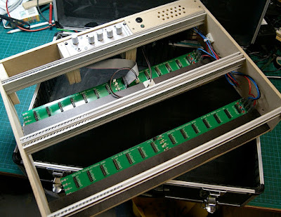

I own the Doepfer DIY Kit. I build my own Wood case for it but i´m not stisfied with it as I build it not in a really proper way.
So I´m looking for inexpensive Cases to fit my DIY Kit into. Any suggestions ?

there are some aluminium toolcases available that fit 84hp.
for example this one (the largest):
https://www.bauhaus.info/werkzeugkoffer ... p/11143100
you may need some piece of wood left and right to hold the rails. The lid cannot be removed (but it is possible to do this also, but it is a bit more evolved). I would also recommend to get an additional piece (thin, 3mm or so) to mount the busboards and the power supply. And then fix the whole thing into the case using some velcro (at leat this is what i do).

Those toolboxes have the perfect width for 19" rails. You can even mount the rails directly to the sides of the box without an additional frame. The hardest thing is to replace the hinges for the lid with some hinges that allow you to remove the lid.
However these boxes are not the best build quality. They're certainly ok for a case but after using such a box for a while I went for a 10U 19" Thon case. They're super sturdy and you can get them in various sizes.
Thon even builds you custom sizes on request. This could be worth a try since the lids are a bit shallow and depending on the height of your cables' jacks you might not be able to close the lid patched. It works with Doepfer cables though.

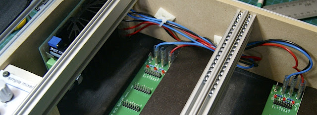

I also started with a Doepfer DIY kit and a 16EUR toolbox (almost perfect dimensions).
Modular got me into DIY and this was my first ever project in this domain (as visible by the quality of 'craftmanship'). Nevertheless I'm very happy how it turned out and how it lowered my barrier of entry.
It's now being regularly filled with DIY kits.
Hope my example helps :)

as others have said (and there are a few more examples now in the thread): yes, all you need are some wooden panels to hold the rails (and fit the size).
Additionally, i would recommend to get some thin plywood, slightly smaller than the (inside of the) back of the case to mount the busboards and the power supply and then put it on the bottom of the case. I use a small dc cable to connect the power supply to an external jack.

Jay F.
Posts: 134
Joined: Mon Jul 17, 2017 12:20 pm
Post by Jay F. » Sun Feb 04, 2018 3:56 pm
Hello,
thanks to the examples of euromorcego and L4nd3R, I made one tool case synth as well. Thanks guys !
Full story here : https://growyoursynth.blogspot.com/2018 ... -case.html
