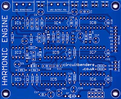

Just thought i'd start a thread about the circuitbenders.co.uk Harmonic Engine PCB.
"......The circuitbenders.co.uk Harmonic Engine PCB is a clone of the E&MM Harmony Generator. This was a project originally designed by Paul Williams, and published in Electronics & Music Maker magazine way back in 1981. The circuit uses a 4046 Phased Locked Loop (PLL) to generate a squarewave oscillator output at harmonic intervals to the frequency of an input signal. The squarewave generated can be set to plus or minus up to three octaves from the input, and can also produce 3rd or 5th harmonies.
Thats the theory anyway. In practice the note tracking only works reliably if you use very basic waveforms at the input. If you use anything else, then everything very quickly descends into a beautiful kind of chaos, with all kinds of bizarre gurgling digital squeaks and squeals vomiting forth. Its especially effective with percussion sounds, converting each hit into some kind of warped electronic splatter."
If anyone comes up with any interesting builds or mods for this board then i'm more than happy to put up a post and link on the circuitbenders site.

4526's do appear to have proven unexpectedly difficult to get hold of.
I've no idea about the US, but i got a few from CPC in the UK
try MC14526B, or CD4526, or HEF4526B

As for mods, maybe compare schematic to BMC 4046 shaper?
Is there a schematic for this thing?
crustypaul
Posts: 45
Joined: Sun Aug 25, 2013 1:05 pm
Post by crustypaul »
Schematic at: http://www.mediafire.com/view/a823scr2t ... ematic.png
Original E&MM Harmony generator schematic that doesn't use pain in the ass Eagle parts at http://www.experimentalistsanonymous.co ... erator.PDF

Great sounding project I really like the way circuit benders use electronics so creatively in unexpected ways.
Can you please let me know what difference would it make if I use mylar caps instead of poly film? Are any crucial?
Thanks 8-)

Ayab wrote: Can you please let me know what difference would it make if I use mylar caps instead of poly film? Are any crucial?
I'd be astonished if it made any difference whatsoever. As far as i know mylar is just a brand name for a type of poly film cap.
bloke_zero wrote:Will it run at 15V? Thanks!
Yes, theres a 9v regulator and it pulls very little current, so 15v should be fine

hmm this atleast is readily available.
http://www.mouser.com/ProductDetail/ON- ... ASSAVqo%3d
need a converter. anyone got a good source for pcb to convert SMD to DIP.
maybe it could just be fudged by bending pins?

There are lots of adapter pcbs smd to th you can buy them for almost nothing on ebay

masterofstuff124 wrote:Mouser doesnt carry 4526?
were can I get it from?
I got a few hits on ebay searching CD4526
