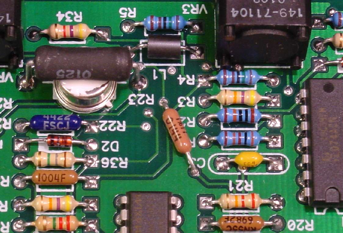

EATyourGUITAR wrote:
latigid on wrote: What is the temperature coefficient of the resistor pair?
the resistors are panasonic 3300ppm
Those resistors are +/-5% tolerance and their TC tolerance is +/-10% which is no way tight enough for two VCOs to track without a lot of selection and/or trimming.
If you use wirewound resistors from the same batch the TCs will be the same whatever the tolerance because they are made from the same reel of wire. If you buy them at different times there is no guarantee of matching. SMD components will be all over the tolerance range. Caveat emptor and good luck with the heated oil baths.

EATyourGUITAR wrote: I reread your post a few times and you did admit that people can adjust the trimmer and it will be fine.
I did not, read it again.
By selection I meant testing parts for the correct 3354ppm TC before mounting, which is something the manufacturers cannot do (I have asked them), and by trimming I meant a method like Ian Fritz's.
this solution of using two 1K SMD tempco's was posted 2 years ago on muffs and no one had a problem with it at that time.
The only thing that is a solution for is not being able to buy a 2k part.
we all have different levels of perfection that we are willing to accept with synthesizers.
Perhaps you would like to state what tolerance you find acceptable without descending to immature personal insults?
the bad producer wrote:Regarding Graham's comments re the tempco, would it not be possible (can you get these?) to use tempco's with smaller TC tolerance? So saying me who wasn't really aware (bothered?) that tempco's had a TC tolerance before, certainly not seen it mentioned much, or maybe I've forgotten?
Most people do not understand what the TC resistor is there for or how to test it. It is not, as seems to be believed, to make a VCO stable at one temperature or to make several VCOs stay in tune with each other, but to keep the VCOs at the same tuning when the temperature changes.
When the temperature changes the transistors will cause both the absolute pitch to shift and the V/octave spread to change. The absolute pitch shift will be greater at lower notes because it is multiplied by the Vbe. When Vbe = 0 the VCO will normally be at it's highest frequency, say ~16kHz, so it makes sense to test how much middle C shifts, six octaves down from that with a Vbe of 6 x 17.8mV.
Without temperature compensation you can expect middle C to shift 5.5 semitones with a 25 degC temperature change. With an exact 3300ppm TC resistor this can be reduced to 9 cent pitch shift and a 7 cent error over a 5 octave keyboard, but if the part is +/-10% tolerance it will go from 3000ppm and a -59 cent shift with -49 cent span error to 3600ppm and +40 cent shift with 33 cent span error. Either extreme is a unplayable out of tune keyboard.
Due to the way they are manufactured wirewound resistors from one reel of wire will closely match each other in the same batch. The manufacturer cannot pick a reel of wire that will give the required TC because it changes during winding so they have to test samples after manufacture and grade them. I think I got lucky with the first batch of Q81s I ever bought, the problem only becomes apparent when you go back for more and put two VCOs from different batches together. If you buy a synthesizer with all the VCOs built at the same time they will match each other, but may not remain absolutely in tune over temperature. That's why analogue polyphonics have a tune function and use a self calibration lookup table.
I have had some +/-1% TC resistors made, but I really wanted +/-0.5% for a "drop in and forget" part and the manufacturer couldn't do it.
With film resistors due to the manufacturing process the TC will have a spread and the manufacturers specify a wide tolerance because they know they cannot select finer. You also get the spread within a batch so there is no guarantee that two VCOs built at the same time will track unless the components are tested and matched and that is a pain.

EATyourGUITAR wrote: can someone tell me the typical TC tolerance for TO-92, SOT-363, PDIP8, CDIP8?
They don't have a temperature coefficient they have a thermal resistance which is quoted by the manufacturer as it varies per device, not per package.
if you are that concerned with the two 1K tempcos having matching TC to each other
You have the wrong end of the stick. The resistors have to have the reverse TC of the transistor they are compensating.
after all, this is how you would build them way way back in the days of synthi is that right?
The VCS3 was originally designed to use dual can transistors. EMS left them out because they were cheapskates and because most of the customers didn't notice, even though it was awful. Those that did put them back in.
Two discrete transistor packages do not achieve temperature balancing, especially with Araldite between them, they need to be on the same substrate to do that. Balancing and compensation are different, both are needed.
