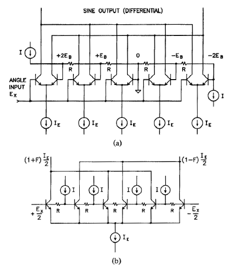

just wanted to add some information that i recently found. im finishing off my OTA sine waveshaper paper (finally, its only been a year of procrastination), and collecting all the sineshaper papers i can find, when i came across a really sweet circuit by barrie gilbert. it was used in the AD639 trigonometric function IC:
http://www.analog.com/media/en/technica ... /AD639.pdf
there are 2 cool things about this: 1. it has -74dB THD, which is better than all options except OTA with cusp cancelling, and digital techniques. 2. it can modulate to +/-500 degrees in its current state, and the circuit can be expanded with more stages to whatever number of degrees you want.
what is particularly interesting here, is that it opens up the possibility of doing PM without messing with the integrator in any way (no TZVCO required). you can merely add your phase after the VCO and send it to the waveshaper to deal with the wrap around. there may be some caveats here, i havent fully thought it through yet, or built one up.
the AD639 is long out of production, but the circuit isnt too horrible to do in discrete, and an OTA version is possible as well, but requires a lot of OTAs. not sure if its any easier than a TZVCO, though.

guest wrote: ...... what is particularly interesting here, is that it opens up the possibility of doing PM without messing with the integrator in any way (no TZVCO required). you can merely add your phase after the VCO and send it to the waveshaper to deal with the wrap around. there may be some caveats here, i havent fully thought it through yet, or built one up.
The AD639 seems pretty amazing.
Can you share your discrete schematic? :-)

heres the basic layout, from his paper on the chip:
there are 2 different ways of going about it (plus variants on these, which are listed in the patent). the top one is the most straightforward, and makes the operation easier to understand. basically, each diffpair is seperated by pi*Vt volts from each other, which is a large voltage, so only one diffpair is active at a time, except for a small period during changeover. each diffpair does the usual tanh function, approximating 180 degrees of a sinewave. for each diffpair, you get another 180 degrees. the diffpairs can be replaced with OTAs if that seems easier. the lower schematic is a reduced transistor count version that only uses 1 transistor per 180 degree section. seeing as only 2 diffpairs are ever interacting at any point in time, there could be a circuit which would take a look at the current position, and move the less active diffpair to the side its most likely to transition to. there would inevitably be some crossover distortion in this scheme, and you would need comparators for all the breakpoints (or a folding ADC of some kind).

guest wrote:heres the basic layout, from his paper on the chip:
That.... is breathtakingly beautiful.

Post by guest »
yeah, that is one of the coolest circuits ive seen.
ive reworked it into a 4 transistor version that has less than 0.05% error over +/-180 degrees, or less than 0.3% at +/-360 degrees. there is still the issue of temperature drift, which is fixable, but starts the push the circuit complexity into the realm of not really worth it.
