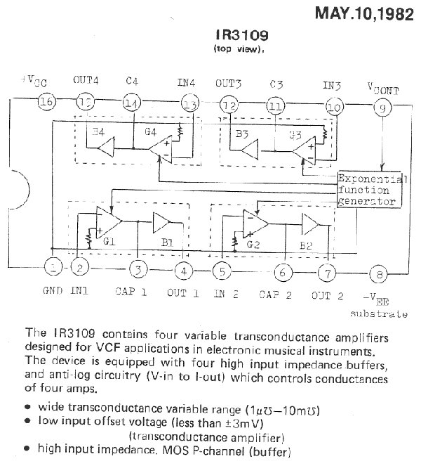

i have a bit of free time while i wait for boards to come in, so i thought id reverse engineer the ir3109. i opened up my shruthi and popped it out, and am hoping i dont fry it. at any rate, heres what i got so far:
basically its an expo converter, 4 OTAs, and 4 buffers. im assuming the OTAs are ba662 cores, and will verify that next. the expo converter will be a bit tricky to exactly nail down, as little of it is exposed, but from looking at the roland filters this chip replaced, its most likely a pnp/npn pair. i will have to think of a good test to convince myself of that. and, the datasheet says it uses P-channel output buffers.
so, i just finished with the output buffers. they are indeed P-channel, with a Vgs of around 3V. there are two diferent schemes used. buffers 1/3 use 20k pullup resistors, and buffers 2/4 use 1mA current sources (2 pnp current mirror). this was suprising, but after looking at roland synth schematics it makes sense. the 2/4 buffers are used as the output stage of the 2/4 pole filters, and need extra drive to feed the next stages.
the input current on the FETs is less than 20nA, and im not sure i can measure any more accurately than that as the gate is directly connected to the output stage of the OTA, so its hard to disambiguate where the current is going. even with the OTA off, there may still be some leakage in that direction.

the OTA sections are ba662/lm3080 style cores. just that pesky expo converter left.

I'd guessed the buffers were FETs, since Roland seem to love FET buffers in many of their OTA filters. That's a part of the Roland sound, for sure. The info about the current sources for the other two stages is very interesting - makes sense, like you say.
The expo convertor probably isn't that crucial for the sound of it, though obviously more octaves and less error would be nice...
Anyway, good work. Can you do a schematic of the equivalent circuit?

yeah, the expo isnt so critical to the sound, but im still curious. right now its looking like the pnp/npn setup, although im not sure how they do the current sharing, and probably will never be able to say for certain.
the OTAs could be easily replaced with LM13700s for this purpose, as the only difference is the current mirror input, and that is driven with a current source, so its unaffected. finding the right FET will be a bit of a needle in a haystack, though.
ill definitely do a full drawing once ive got the last piece.

As part of his replacement module for the Juno 106, analogue renaissance has used 13700's and a matched transistor pair to accurately replicate the 3109, with another 13700 to handle resonance and VCA duties, which leads to the obvious inference, the 3109 is not a special chip, just 4 OTA's and a transistor pair on board. As Roland used the 3109 to replace cascaded BA662's in the Jupiter 4 with a saving on board space and hopefully improved matching, then it would be a reasonable assumption that the BA662 is just an OTA with a transistor pair driving the current. Nothing magical.

very true, OTAs are almost all identical. and, one of the great properties of them, is that the transfer function is not too dependent upon transistor beta, so it doesnt matter too much which transistors you use, as long as they are matched. but, there is more going on than just the OTA.
i looked at the analogue renaissance work while doing background research for this project. i would consider it an "improved IR3109". the current rev seems to use a standard opamp/diffpair expo converter (which will track better, and therefore be different than the original), and uses opamp buffers after the OTAs (which whill have way less distortion).
since the OTAs are running with negative feedback, the buffer is not too important for normal operation, but will make a world of difference when over-driven, or used with lower supply rails. so it all depends upon what the IR3109 is going to be used for.

ok, here are the output stages:
still working on the expo converter. it uses a voltage independent current source to set the bias current, and has a gain of around -290dB/volt. the output is relatively linear over 100dB of its range, which is pretty good. it saturates internally at 700uA, and measuring on the low end is difficult, and quite noisey. i went down to about 2nA before i couldnt discern the signal anymore.

ok, here are the results:
the top drawing is a schematic representation of whats in there, and the bottom drawing is a best guess at how its implemented.
as it turns out, they use an opamp/diff-pair for the expo converter. this gets mirrored off the top rail and sent into a the OTAs with the base currents buffered to ground via a transistor. the bias current is 3uA, and this is set with a generator that runs between +/-Vcc. there is an opamp of some sort that holds this 3uA constant through the reference transistor. for a number of reasons, i believe they used another BA662 for the opamp, and have its bias current set at 3uA as well. exactly how this current is reflected into the BA662 is unclear, but the version shown would use the fewest transistors. im pretty confident about the 1.6k resistor, and that they set the 3uA with a zener source biased with a 20k resistor. the 3uA doesnt have the greatest stiffness with either temperature or Vcc, so something like what is drawn was probably used.
the OTAs on mine were matched to about 5% of each other, so not the greatest tracking.

I'm a little confused as to what you are actually looking at - if you decapsulated an actual Roland IR3109 chip and could see the die, I assume you wouldn't be asking about transistor configurations, as you'd be able to see them, so are you actually reverse-engineering some other 'interpretation' of the chip, as implemented in the Shruthi?!

no, i have an actual IR3109, and ive been probing all the pins and seeing how it responds to figure out the configuration of the transistors inside.
